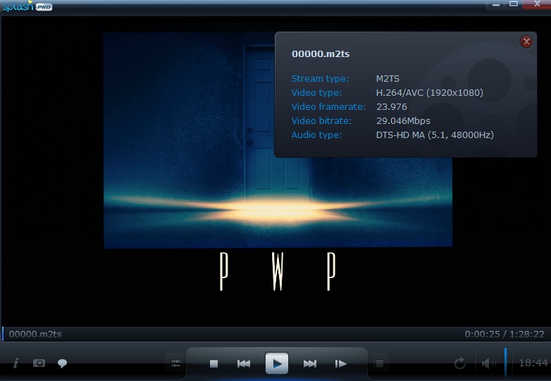

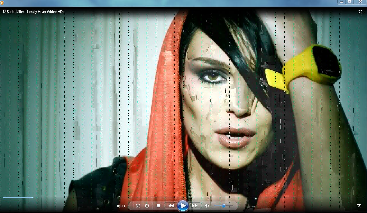

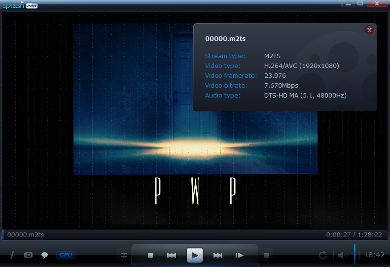

When I play video files in Splash Pro wth video acceleration (Avivo) the image is like crap .(see attachement 1)
When I play without hardware acceleration everything it's ok ( CPU at 50%)(see attachement2)
I must say that this things happens also in WMP and PowerDVD 12 . Any ideas ???
It's anyone out-there with my problems???
Video without hardware acc.
Video with hardware acc.

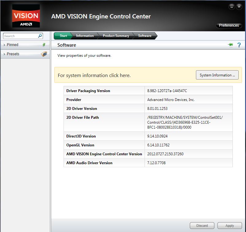

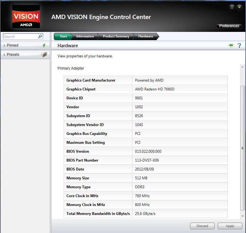

radi wrote:Do you have latest drivers installed?
Yes , I think I hahe (12.8 Catalyst , installed from motherboard DVD , see attachement)
It's possible to be something defective ? (motherboard or APU)
Driver info
Software info.JPG (78.57 KiB) Viewed 40574 times
Hardware info AMD APU 10
Hardware info.JPG (82 KiB) Viewed 40574 times

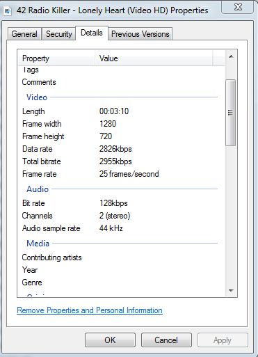

I post next 2 capture files from Windows media player playing an mp4 file , maybe someone help me ...
It's time to call AMD suport ?
Capture properties
Capture properties.JPG (42.54 KiB) Viewed 40573 times
Capture video
Capture WMP.JPG (175.92 KiB) Viewed 40573 times

Mon Oct 22, 2012 6:38 am
Looks like graphical artifacts, I imagine you would see purple triangles all over the screen when playing games to.
This can be caused by drivers, upgrading to AMDs latest beta catalyst drivers may help.
But the more likely cause is that your GPU is over heating, you can check this by using an application called SpeedFan
You should get a screen looking at that, my PC is particularly well cooled, so your numbers should be higher, but if your GPU is running at 80c+, then you are indeed in trouble
Overheating is a likely explanation as:
1. Overheating causes weird artifacts on your screen (just like your experiencing)
2. It only appears during heavy work load (like playing a high res video) (this causes more work for the GPU, so if it isn't properly cooled, overheating)
Hope that gets you on the right path!
