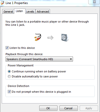

Now right click Line 1 and Line 2 and select Properties. Then go to the Listen tab.
Now do the same thing for Line 1 and 2. Check Listen to this Device and Under Playback through this device select your speakers or Headset. Remember do the same thing for Line 1 and 2.
