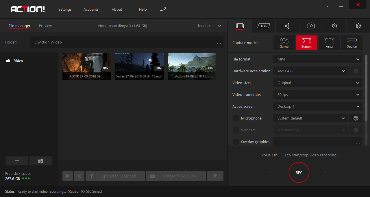

I'm on a Ryzen 2600X and RX580 8Gb with all my drivers up to date, but now Action! is recording games which run at 60fps at around 12-15fps or less and so the recording is all choppy and impossible to watch.
I game in standard 1080 so I don't know what the cause may be. It first appeared in Forza 7 which I was running in Ultra, but then dialled the graphics back to 1080 and Action! is still doing the same. This also happens in Shadow of the Tomb Raider with very low fps recording when I know the game is running at 60fps.
I'm recording using the AMD APP as mp4, pretty much default.
I'm using the Steam version so checked integrity and even reinstalled the software, but it's still recording very badly.
Any ideas what may be causing this?

Anyway, I followed all the steps you suggested and the recordings are still very poor at around 15- 20fps when the game itself is running at a solid 60fps.
As a test I ran Windows 10 Game DVR and that ran perfectly with no stuttering or fps loss at all.
I'm wondering if it could be the AMD 470 Ryzen chipset drivers I installed on Monday since they are the only important bit of software I've installed recently. Last week Action! was recording perfectly, so I'll have to go with trial and error until I find the source of the problem.
It's odd, because when I run Steam's file integrity check on Action!, it needs to keep re-acquiring files as if they have become corrupted.
I'm going to reinstall the chipset drivers directly from Asus and report back.
EDIT
Reinstalled the chipset drivers, no change.
Rolled back Adrenalin drivers from 18.9.3 (Sept 26 2018) to 18.7.1 (July 19), no change.
Ensured that capture mode is set to game and not screen, no change. (I tried screen capture mode for recording games, but that results in lower fps recordings).
I disabled Game DVR also but with no change.
I'm sure this is something logically simple, but I would appreciate a bit more in the way of tips to solve this.

Please provide us screenshots from following tabs:
- Video Recording
- Video Settings
- Audio Settings
Also, please provide us your PC DxDiag report. It will help us investigate your problem.
