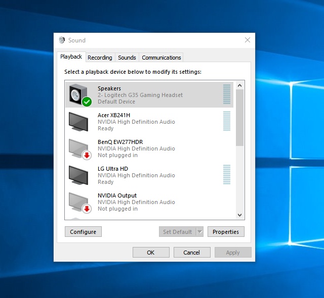

Try this:
- open Sound control panel
The attachment Desktop 10-3-2018 8-12-17 AM-584.jpg is no longer available
- double click on your headphones to open properties,
- go to Advanced tab and disable "Exclusive mode"
Desktop 10-3-2018 8-12-17 AM-584.jpg (81.47 KiB) Viewed 11655 times

I don't have that option, but fortunately I was able to get this working anyway. I returned to using the "Hands Free" option (I had mentioned having two different devices show up in the sound panel for my headphones - one was "Stereo", the other "Hands Free") without ever needing to enable Stereo Mix (thus avoiding the Recording tab crash issue, and that worked. It does mean the quality of the sound I'm hearing is lower, but it doesn't effect the recording quality as far as I can tell, and in any case it seems to be a limitation of the headphones, not Action or perhaps even Windows. Sorry for wasting your time!
