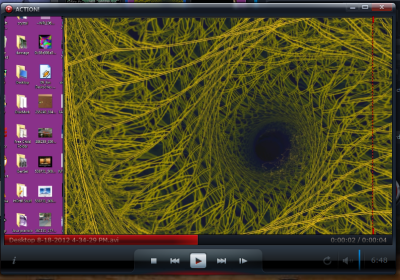

Hi.
I have problem with recording desktop area. But from the beginning. I'd like to record "Minecraft" but each time I try, the game has crash, so I tried to record it as desktop area. Ok, I record about 30 mins and it turned out that the area came right and cut the left side of the game. How could I solve that problem because I tried almost everything...
Here is screen: http://img545.imageshack.us/img545/9898/beztytuunwk.jpg

Hi, do you always have this strange offset when recording with desktop region?
In example when recording dekst region without minecraft running, or with other region sizes and positions?
Do you have original video size set or do you use scalling to 720/1080p or 480p?

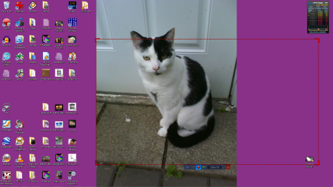

by olyteddy
Ghost wrote:
olyteddy wrote:same here.
The attachment action cut.png is no longer available
BTW: Why so cheap on the attached file size? You do realize 256 KB is way to small for a picture, don't you?
Does this problem occur with every region size and position? or only sometimes?

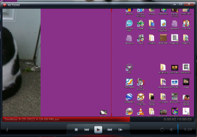

It happens when the capture area is 1280X720. 1024X720 works, 1280X640 doesn't work. It even does it just recording the static desktop.
Desktop showing selected area, during recording:
Screen shot of the player, showing what was actually recorded:

by Ghost
Problem will be fixed in 1.9.2.
Thank you for providing us all details about the problem.
Re: Problem with recording desktop area
Posted: Fri Aug 31, 2012 11:03 pm
by Ghost
Please check the latest 1.9.2 version, all problems with shifted video in region mode should be solved now.
Posted: Sat Sep 01, 2012 7:15 pm
by olyteddy
Thanks. Seems to work now. I use 1280X720 to record pixel for pixel when I record WinAmp visualizations.
