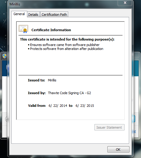

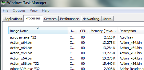

When I try to open Action the splash screen shows for 1 second (literally). Then nothing else no indication that the application is running on the taskbar or minimized to system icon. I have the program set to 'run as administrator' and have tried compatibility modes. 'Action.exe *32' and 'action_logon.exe' run momentarily while 'Action_x64.bin' and 'Action_x86.bin *32' continue to run. So I tried checking the Mirillis Certificate for UAC and upon looking found out that the cert. is valid from '6/22/2014 to 6/23/2015' which if you notice by post date is past the end date. I'm not really sure if that has anything to do with it as it most likely does. Either way I could be wrong.
Certification Information - click to expand
Also I want to note that 'Action_x86.bin *32' and Action_x64.bin' stay open as stated above, but each time you try to open Action! again 'Action_x64.bin' opens again leaving multiple instances of the .bin open.
'Action_x64.bin' multiple instances

Which Action! version do you use? Older version will have listed the old certificate.
