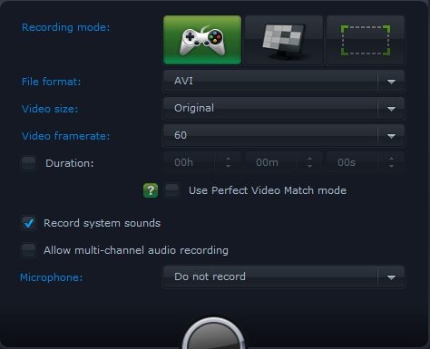

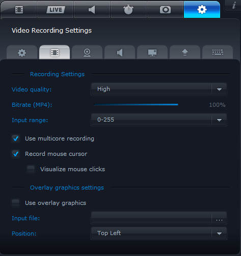

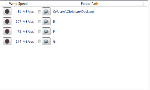

I found out why this was happening.
Its due to your HDD Write speed. I think your HDD has to be at least above 50MB/s write speed in order to record at the high settings.
The link below shows what my HDD write speeds are for 1000MB file. This was done with dxtory since I have that also.
As long as your HDD can write above 75MB/s continuously during recording you should be fine.
The following will work based off a 75MB/s + write speed. It worked for me. But that can be different for some other users. Just from my experience of problem solving this.
