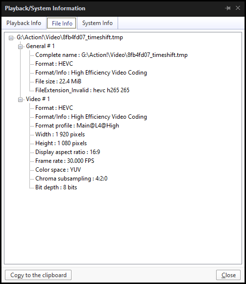

Well we managed to restore your recording.Your files are fine. I am not sure why you have this issue in this game because it makes no difference for timeshift muxer.
Did - by chance - you managed to get audio working with my tmp video? When i try to play it on PotPlayer i get no audio and application reports no audio track in file:
